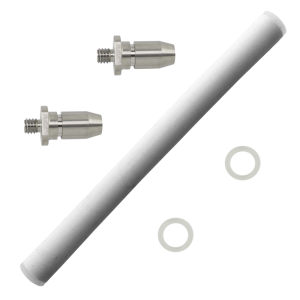

The pump manifold filter is offered as additional protection for the orifice assembly in the nozzle and in the dump valve. Debris generated within the pump or introduced during a rebuild can travel downstream and chip the orifice assembly. This filter is placed between the manifold port adapters and complements the other filters in the OMAX system.
NOTE:To use this filter assembly the port adapters need to have a 5/16-18 female thread in the end. All new port adapters being manufactured by OMAX will accept the filter assembly. If you wish to use the filter assembly but have older port adapters you can order new port adapters from OMAX or you can modify older port adapters using the drawing included in the kit.
